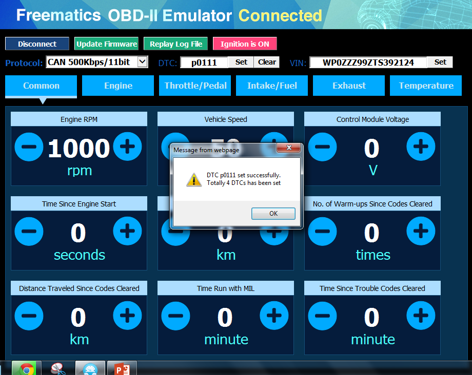

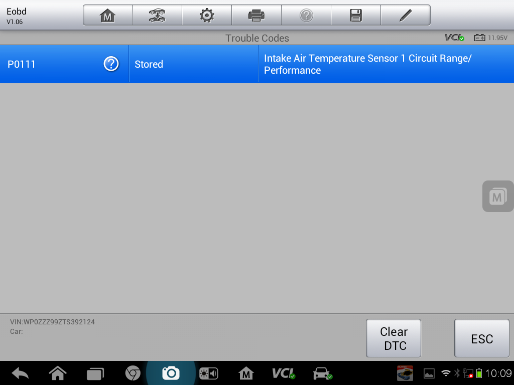

I am having the same issue <p>
Only the last code shows
4 DTCs entered
4 DTCs entered
