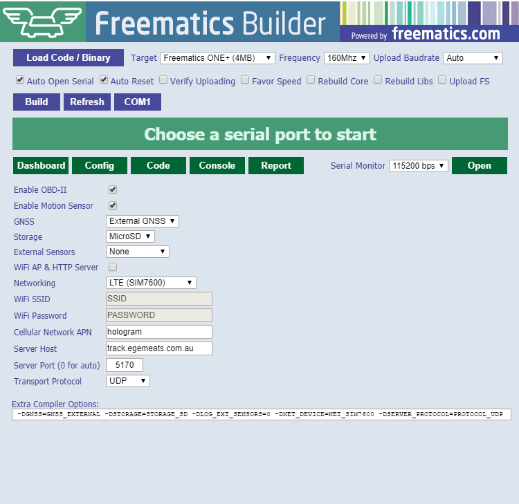

After doing the Freematics Builder configuration according to the guide. (both trackers were configured the same, same place, same PC and same sim providers "hologram") Yesterday two trackers were also tested on the road on two vehicles, and results follow;
  • First Tracker: Was connecting to the sim network & server, but when connected to OBD, the coordinates were showing Latitude 0.000000°, Longitude 0.000000°forwhole road trip.
    SecondTracker: Wasn't connecting to server and sim provider.
Below are the outputs from the Freematics Builder console

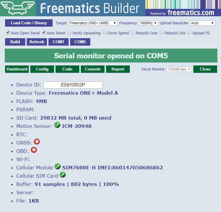

Did you connect GPS receiver as I see you have model A and no GNSS is detected. Try powering from OBD instead of USB alone which might not supply sufficient power surge.

If you see GNSS:NO there is no chance any coordinates will be obtained. GNSS receivers are not detected for some reason. Have you tried both receivers?
As for the cellular network issue, did you test with the same SIM card that works in another unit?

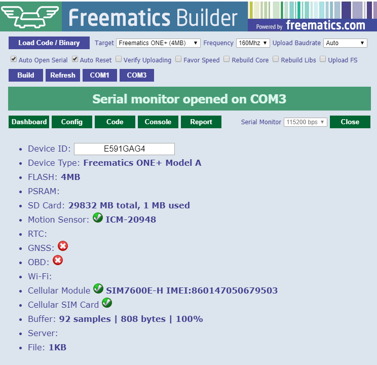

Done a test on the 2. device

trackernsw

Done a test on the 1. device

Re: 2x Freematics ONE+ Traccar Edition aren't working
Make sure to always change the GNSS option to external while compiling as you use external one.
