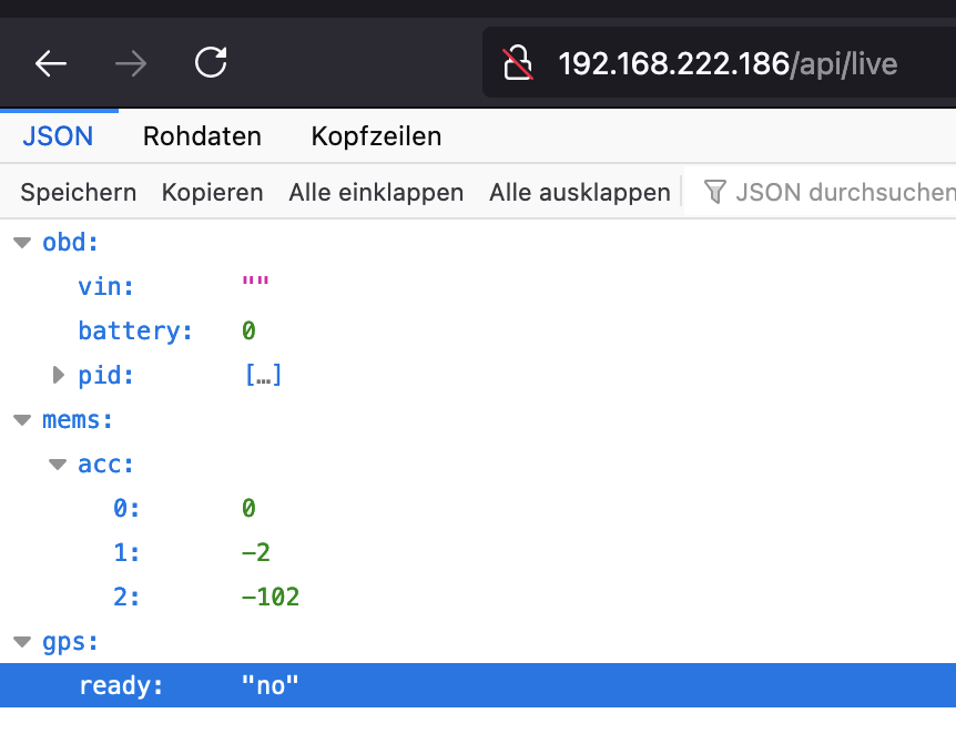

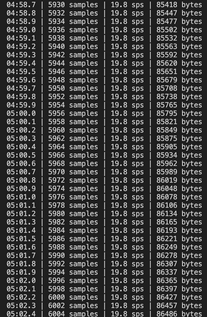

Well, as I wrote it's the same with a SIM put in. But as requested I installed datalogger firmware and even after several minutes I get GPS->ready->"no" in the webinterface. Serial output is also shown in the other screenshot.
GPS -> Ready -> No even after several minutes

That's how the serial output looks like
