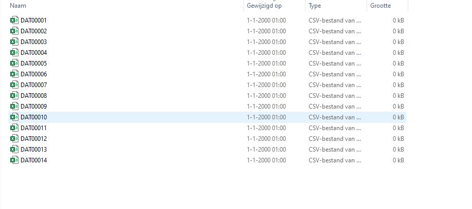

Hello good day
I have upload v4 data logger to my unit but when connect to my car and drive.
Csv files empty
please help
Thanks
datalog 2.JPG (45.56 KiB) Viewed 18847 times
datalog 1.JPG (22.52 KiB) Viewed 18847 times

Re: Freematics ONE sd card empty csv files
Tried re-formatting card?

Hello good day
Yes also another sd card.
But not working
Thanks
In your serial output, did you see number of bytes (written to card) like following.
333 samples 26.2 sps 4428 bytes
342 samples 26.4 sps 4554 bytes
351 samples 26.6 sps 4680 bytes
360 samples 26.8 sps 4806 bytes
369 samples 27.0 sps 4932 bytes
378 samples 27.2 sps 5058 bytes
387 samples 27.4 sps 5184 bytes
396 samples 27.5 sps 5310 bytes

I now remember that there was no more that in the picture (Serial output)

Did you see (flush) ever appeared in the serial console?
