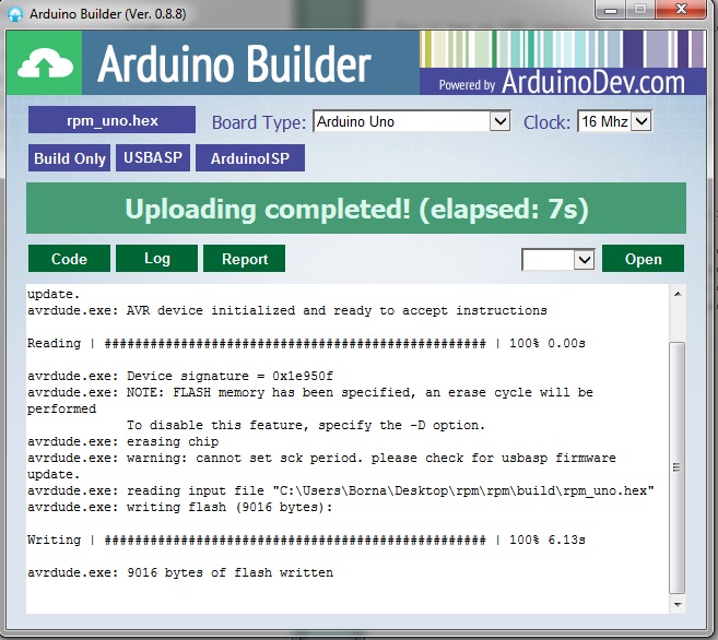

I purchased a V2 adapter recently. This one is the 328P. I can program it just fine, and have tried a multitude of sketches both using Codeblocks and Arduino builder and the Arduino IDE. I can program using both methods, however, nothing seems to function. I get an sck cannot be set warning using both methods.
Using the USBASP I purchased from you along with the dongle, see attachment for the program write log.

- sck.jpg (141.12 KiB) Viewed 43732 times
