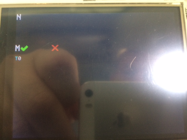

I'm unable to get my OBD kit working correctly.
I have compiled and uploaded the code but when I plug it into the OBD port (Subaru 08 WRX ADM) I get on the screen a N then a M with a green tick then a few characters over a red X then on the next line a T0.
Does anyone have any idea what is happening?
I have attached a image to show what I have on the screen.

Use Arduino 1.7.8 from http://www.arduino.org/software and this issue will be solved.

Stanley, thank you so much. Finally got it up and running. Now to play with some code.
