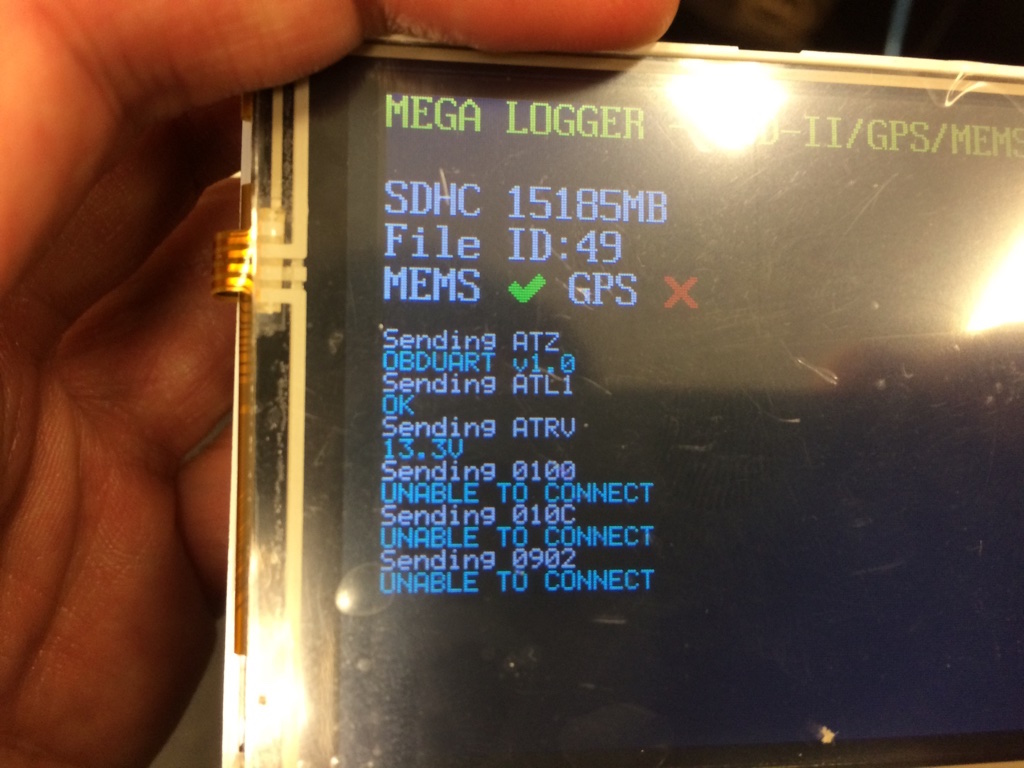

I bought a kit#3 with UBX-G6010 and IIC adaptor. When I plug it into my 2007 infiniti, the LCD shows that the OBD-2 command cannot be sent (UNABLE TO CONNECT) and GPS fails to recognize. MEMS seems to work fine.
Attached is the screen I took.
Could anybody help me?

kit #3, OBD-2 "UNABLE TO CONNECT"

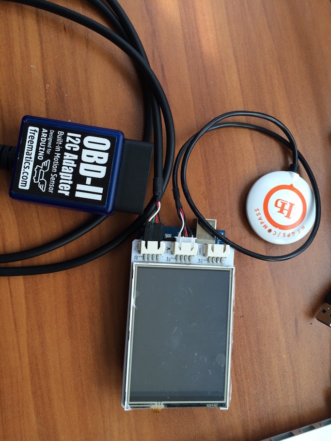

Hi Stanley,
Thanks for your kind reply.
My car model is 2007 infiniti g35x.
The baudrate is set as default, which is 115200 bps.
Here is the GPS configuration:
#define USE_GPS 1
#define GPSUART Serial2
#define MAX_GPS_PROCESS_TIME 50
#define GPS_DATA_TIMEOUT 2000
#define GPS_BAUDRATE 115200
Attached please find the picture showing the wiring of device, as well as the model of the used GPS. OBD-2 adaptor is plugged in IIC interface and GPS is plugged in UART2, which is in the middle.
Thanks again.
Le Guan

Re: kit #3, OBD-2 "UNABLE TO CONNECT"
Infinit G35 2007 does not use a protocol that our adapter supports.
What protocol does it use? I wish there was a simple way to lookup what cars have what protocols. Googling around seems to come up with mixed results for every car I look at. My 2007 subaru for instance didn't work with the auto select. But if I force the right protocol (PROTO_KWP2000_FAST), it works perfectly fine.
