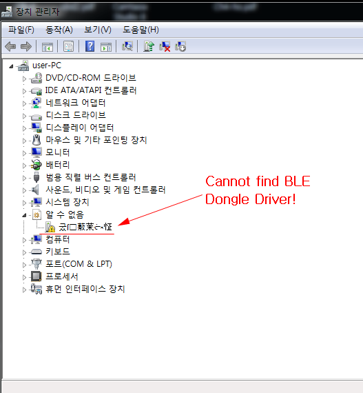

Hi Stanley. I bought OBD Emulator and Freematics Data logger few days ago. I also bought BLE Dongle when I ordered Data logger. I want to use BLE communication between Data logger and my desktop but when i insert it into my usb port, BLE driver cannot be found. I also tried to find driver but I cannot recognize this dongle device's name. I attached a picture. As you can see in this picture, Device's name is strange. Please tell me where i can find this dongle's driver. Thanks!
2015-09-08 10;13;17.PNG (46.08 KiB) Viewed 10050 times

Normally the BLE USB dongle driver is automatically obtanied and installed by Windows (7 or later). If no luck, please download TI CC2540 software package and you will find cdc driver in C:\Texas Instruments\BLE-CC254x-1.4.0\Accessories\Drivers
