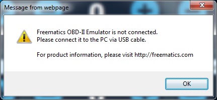

It still does not connect to the GUI.(Error Screen shot attached)

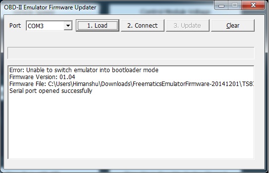

Neither is it getting updated.(Error Screen shot attached)

- Error on firmare update tool
- Freematics MK2 error.jpg (46 KiB) Viewed 7339 times
- Error on GUI
- On GUI.jpg (28.78 KiB) Viewed 7339 times
