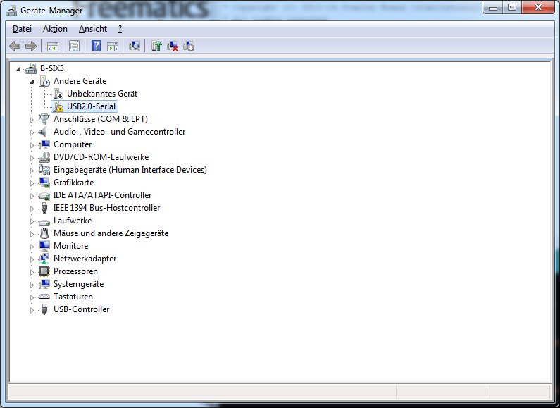

When i plug it into my USB port, Windows 7 detects it as "other devices - USB2.0-Serial" (see Bild1.png attached below). This does not look very familiar with the tutorials I have found online.

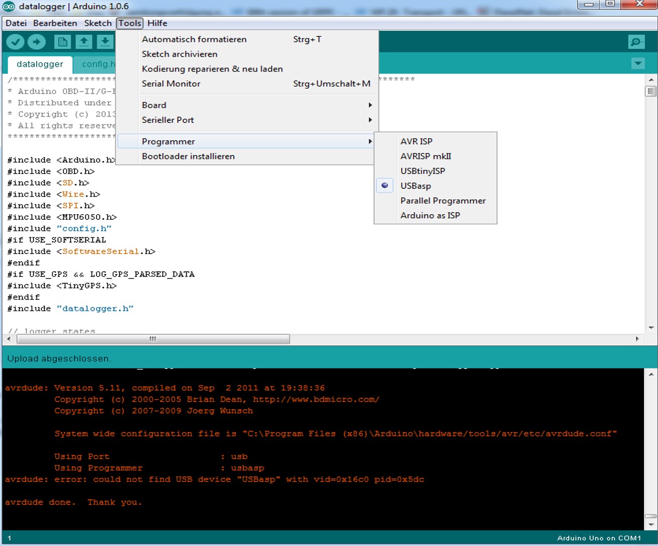

If i finally try to upload a sketch using Arduion IDE I get the error message as illustrated in attached Bild3.jpg.
Any advice what I handle completely wrong, or do I have a problem with my USBasp?

The driver is not properly installed for the USBasp.
Here is the driver:
http://www.fischl.de/usbasp/

Thanks for your fast feedback, I already tested that one. No success.
I also tested on different PCs but it seems the USBasp is not working properly.
Finally I used an Arduino UNO eval board as ISP and this instantaneously did its job.
