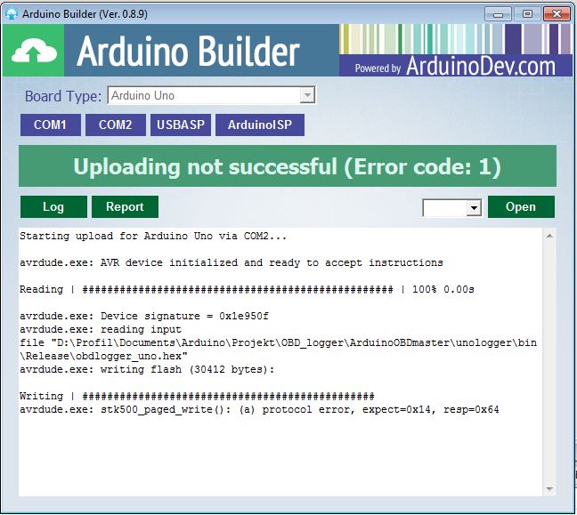

I get and error when I try to upload the "unologger" project to an Arduino UNO using the build in Arduino Builder in Codeblocks.
(downloaded from http://sourceforge.net/projects/obdcon/files/logger/, downloaded 17-08-2014)
Everything compiles fine in Codeblocks but the upload always stops at 94% and an error message appears.
The message says "avrdude.exe stk500_page_write(): (a) protocol error, expected=0x14, resp=0x64"
No problem to upload other programs via Codeblocks to Arduino UNO so the configuration of Codeblocks seems to be right...

The reason is that compiled HEX is too big to fit on the target. Arduino UNO has 32KB flash memory but normally only 28KB (on some boards) or 30KB can be used.

The sketch is provide AS-IS. If your UNO board uses 512byte boot loader instead of generic 2KB one, you will be able load it. Otherwise, you need to fine tune the sketch to reduce the code size by yourself.

I reduced the code so now it works
