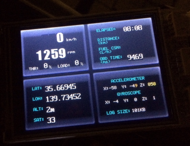

Indeed - I've actually just been playing with my new kit #3 on my motorbike (Triumph Tiger 1050). It works just fine by the way! They use OBD-II, CAN-bus etc just like other vehicles...

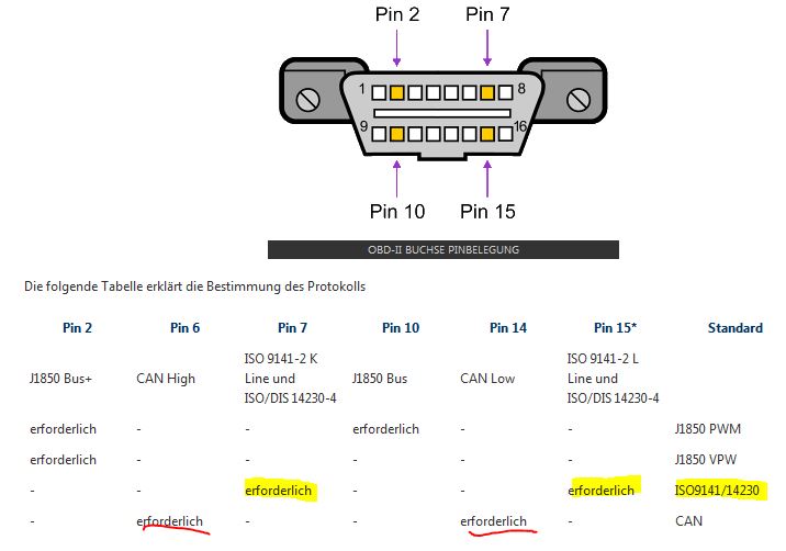

Hello,Stanley,
i have got your OBD II Adapter for Arduino,Type B.
I try to connect it to my Ducati.
The Ducati uses the same MagnetiMarelli ECU, like giulio mentioned few posts above.
The protocol,that this ECU supports, is KWP2000.
The description of your OBDII Adapter states,that KWP2000 is supported.
Unfortunately,i can not connect to the ECU of the bike,and i am looking for this issue.
Question: Where can i set the protocol to KWP2000 in your Logger-Sketch? I have seen "protocol=0" which means automatic.
Could you please take a look at the picture included in this post,if pin7 is supported (this is used fpr KWP2000 and CAN via K-Line),
or if only the pins 6/14 are working.
Thank you very much.
