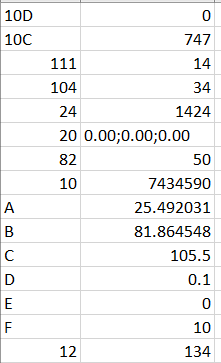

(ii) The data collected during field trials and stored on the SD card does not include a header or timestamp. We’re unsure if the data is valid and whether this is the expected format.
These issues are critical for our research, and we would greatly appreciate any assistance or suggestions. I’ve attached the screenshot of sample data from the SD card.
