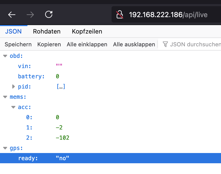

Posted: Fri Jul 09, 2021 6:59 pm
by sboldt
Well, as I wrote it's the same with a SIM put in. But as requested I installed datalogger firmware and even after several minutes I get GPS->ready->"no" in the webinterface. Serial output is also shown in the other screenshot.
GPS -> Ready -> No even after several minutes
Mozilla Firefox - (Privater Modus) 2021-07-09 10-53-50.png (61.04 KiB) Viewed 13504 times
