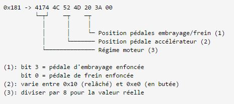

I also have the same question. I want to have brake Data for my Renault Clio 3 and i also know the adress :
https://x0r.fr/blog/39The brake pedal information is on :
(see image)
- pid.JPG (25 KiB) Viewed 21935 times
 (1): bit 3 = clutch pedal pressed
     bit 0 = brake pedal pressed
(2): vary between 0x10 and 0xe0
(3): divide by 8 to have real value
Can someone explain how to sniff this custom PID: 0x181 -> 4174 4C 52 4D 20 3A 00
I looked at the library and I don't understand how I can implement this, because the adress is 0x181 and in wikipedia, usual PID have different format (#define PID_ENGINE_LOAD 0x04 for instance).
Thanks for your help.
Regards.
