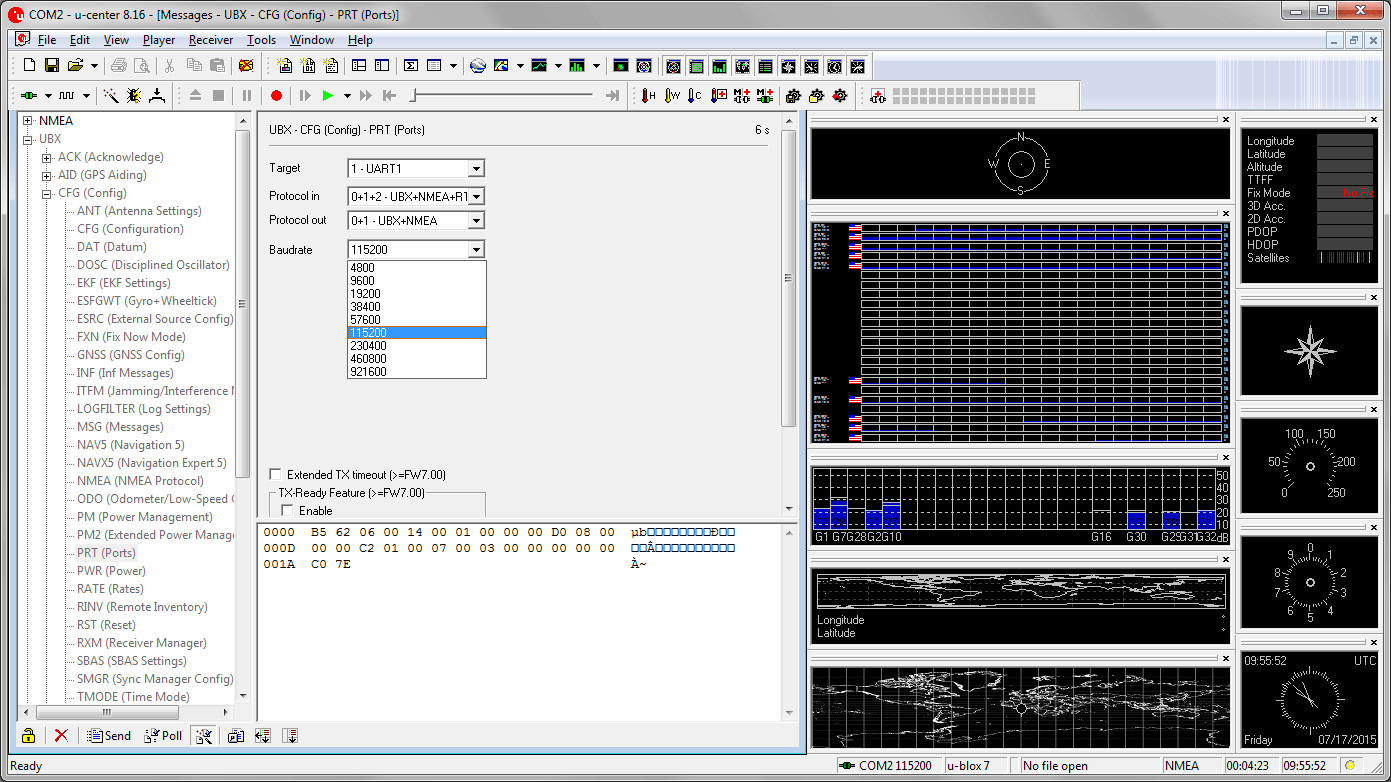

Navgiate to UBX -> CFG -> PRT to change the serial port baud rate and click Send button located on the bottom.

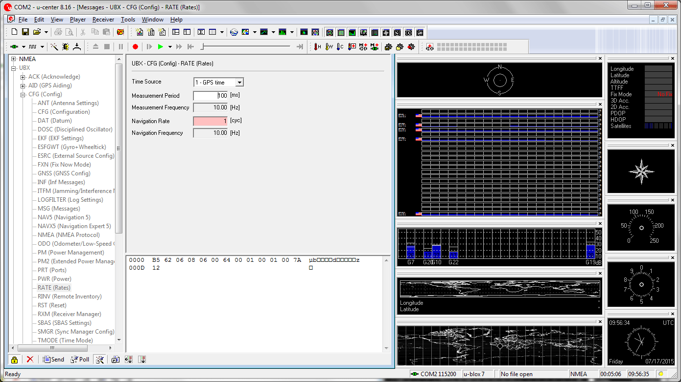

Navgiate to UBX -> CFG -> RATE to change the GPS data rate by changing Measurement Period and click Send button located on the bottom.

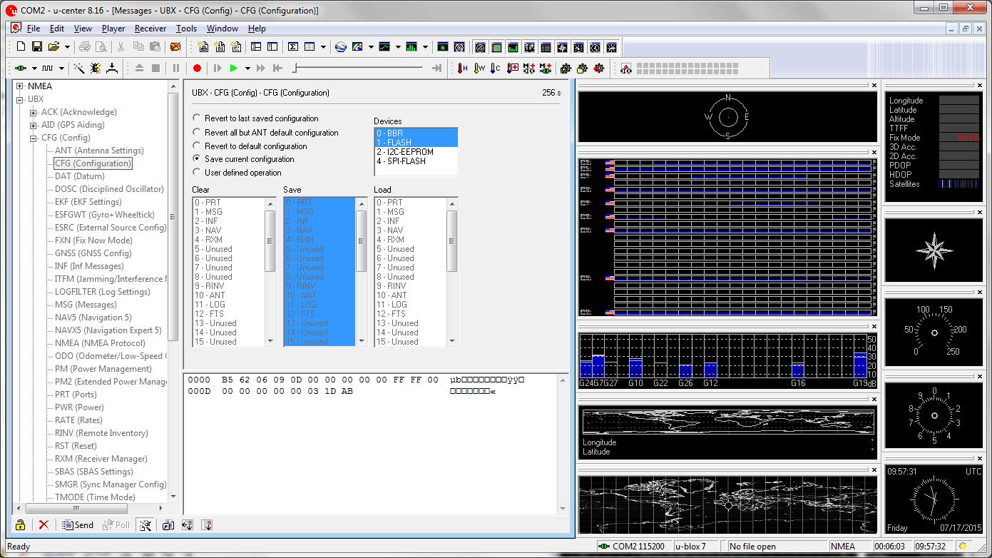

5. Save the changed settings permanently.
Navigate to UBX -> CFG -> CFG and select 0-BBR and 1-FLASH in Devices list and click Send button located on the bottom.

This guide suffers from a silly mistake.
At step 4, once you click "Send" after changing the baudrate, your GPS device will immediately switch to the new baudrate. This will terminate all communication with the u-center software, since u-center still attempts to use the old baudrate. In this state it is pointless to proceed. It is pointless to try to change UBX -> CFG -> RATE or perform the step 5 (saving the settings) since none of these steps will work - u-center has lost communication with the device.
You have to re-establish communication by matching the baudrates first.
The correct sequence of steps is as follows:
* Step 4: Select the new the baudrate and click "Send" in UBX -> CFG -> PRT
* Immediately go to "Receiver -> Baudrate" menu in the main window and select the new baudrate there. Confirm that NMEA messages in the Text Console resumed updating (meaning that u-center has successfully re-established the communication with the device at the new baudrate)
* After that you can resume the sequence: proceed to configure your device (UBX -> CFG -> RATE and/or UBX -> CFG -> CFG to save settings)
