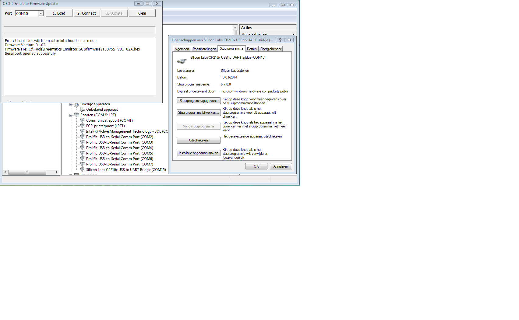

Also Firmware update was not possible, tried to reinstall the driver en Re-Update, same results.
Also tried it with a different USB cable, also same results.
(See the PDF Attachment of the installed driver & the messages op the FirmwareUpdater)
What else can I do ?
thanks in advance

Yes COM port number = 15
I attached a PDF with my previous post..(Not sure if you did see it, attached it again as .PNG with some screens in it..)
I am afraid it did arive dead, but the COM porrt is deteced by windows [Vista x64] when connected.
thanks in advance

- Some screenshots
- MK2 - Port & FirmwareUpgrade.png (91.25 KiB) Viewed 26515 times

I was NOT completly sure nothing has been connected at that time so I ran a new upgrade session, see photo..
Also I changed the comport since last time, now it is ComNumber 8, and is opening without errors, however NOT commubication with the "Processor" inside..see photo
Photo : Same results as last time except for the port number (Now 8)
regards and thanks in advance,

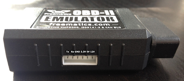

after having tried to get an reply on my "Dead on Arival" RMA request in the FreeMatics shop (Website), at this time already since 27th of August 2014, and still without any result or reply...shame on you..I finally did some testing myself (Without opening the product). As it seems the power regulator part inside must be broken.
On the connector on the side 3.3 Volts is missing as well as 5 Volts.
The 12 Volts power on the outside pin is correct.
When you are not willing to give any product support, please sent me at least a schematic diagram of the internal (or part of it) so I can fix it myself and finaly start using the equipment which is in my posession now already for ~~8 weeks in a NON functional state.
Greetings M.A.W.M. Nijland (Netherlands)
a very unsatisfied customer..
- Side-Connector.png (201.83 KiB) Viewed 26230 times

DonL wrote:Windows Vista is so bad, that it did not survive a year, Windows even put out a new version, Windows 7 because of all the bugs, May I suggest that you borrow a laptop with Windows 7 and try it before condeming the device. It may just be Vista blocking serial coms. I have seen this before and upgraded my laptop from Vista to W7 because of all the problems connecting to vehicles.
Sorry to tell, but this is not what the problem is..
Also used Windows 7 and Windows XP, results stay the same (similar)
The problem is a broken power supply inside the box.(Must be, no power comming out except for the supplied 12 Volts..
So probably also the Processor inside the box is without power ..
