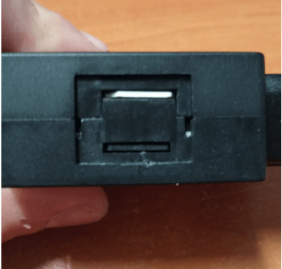

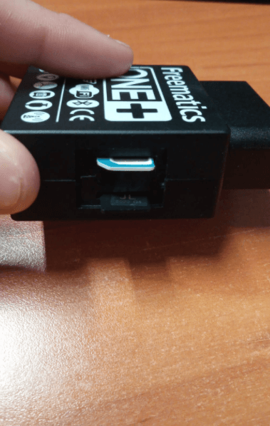

Re: 2x Freematics ONE+ Traccar Edition aren't working
Using a new sim, with the Freematics ONE tracker. that's it.
I'm 100% sure its inserted correctly, like in the guide https://freematics.com/pages/products/f ... art-guide/
trackernsw
- Posts: 43
- Joined: Wed Oct 27, 2021 6:22 am
Images of how the sim card & sd card is installed
- 3.PNG (55.56 KiB) Viewed 29920 times
- 2.PNG (91.53 KiB) Viewed 29920 times
- 1.PNG (130.81 KiB) Viewed 29920 times

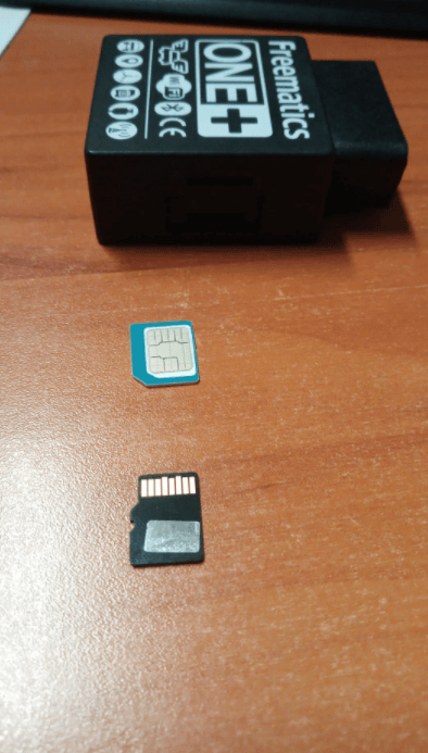

trackernsw
- Posts: 43
and this one too
- 4.PNG (110.89 KiB) Viewed 29920 times
