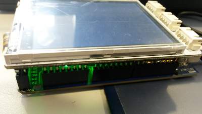

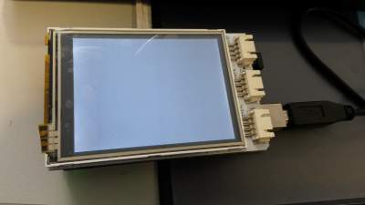

Here are some pictures of the arduino with the display:

Are you sure the sketch is successfully compiled and uploaded to the board. I also noticed the screen shield is not fully inserted.

What you've got is 3.2" LCD instead of 2.8". It seems you did that wrong in config.h.
