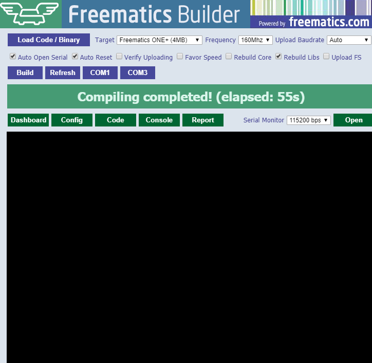

When i changed the line on the FreematicsPlus.cpp (the library, ticked the rebuild libs. after building. then selecting the COM3, there is a blank screen no outputs are given.
- Capture2222.PNG (35.45 KiB) Viewed 22807 times
Re: 2x Freematics ONE+ Traccar Edition aren't working
Freematics Builder version 1.2 was just released. I suggest you doing an upgrade. If still no luck, please use PlatformIO or Arduino IDE.

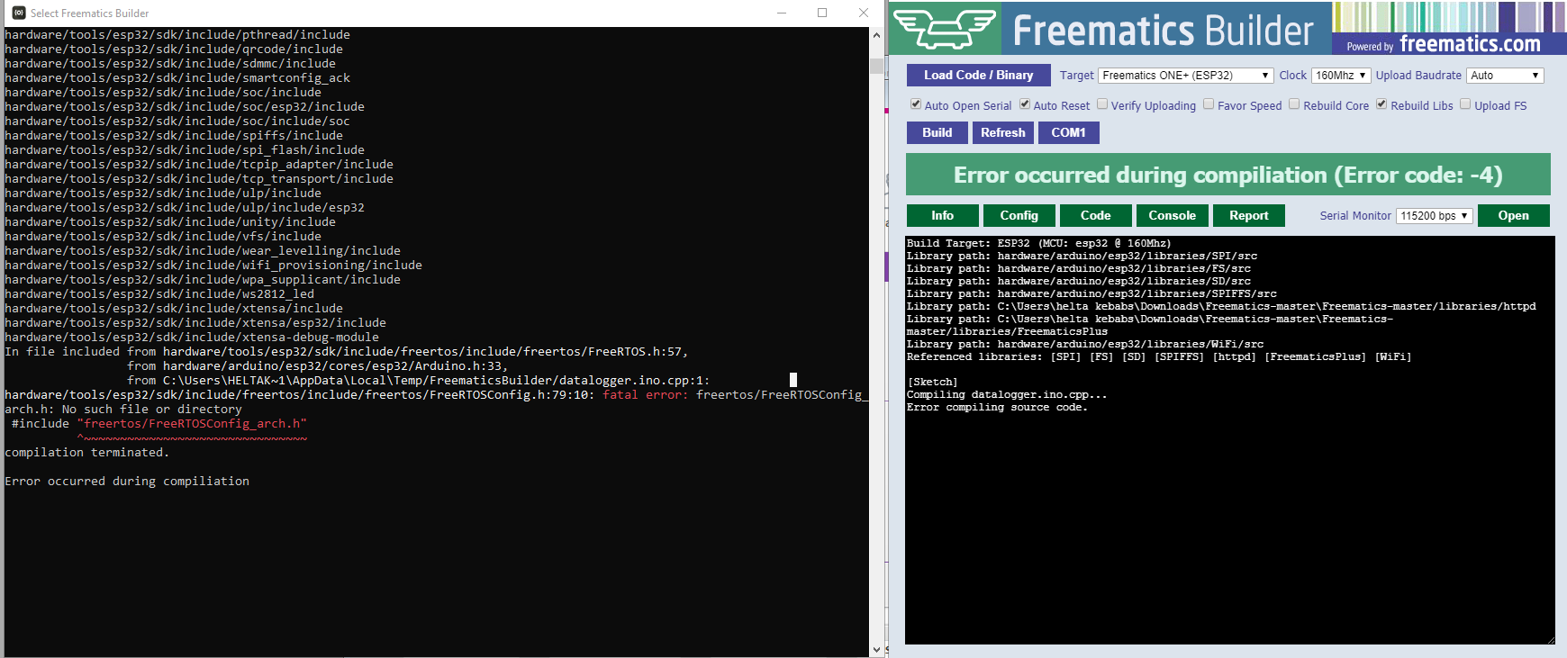

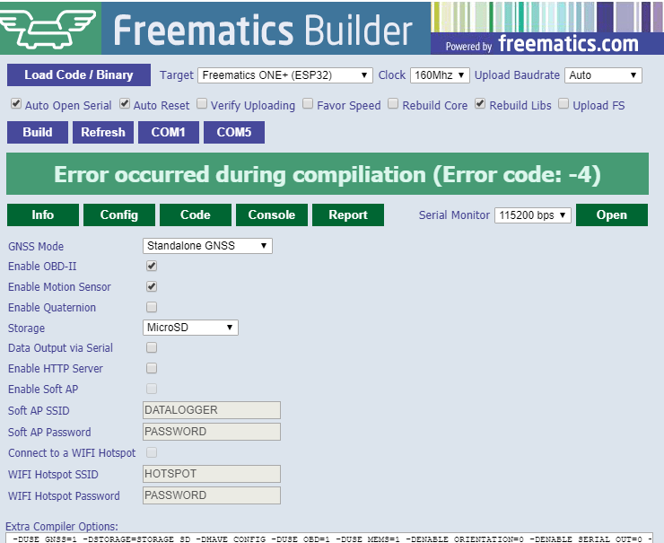

Your new update is generating errors. Please see attached.
Also, the config settings are different on this new version, can't select sim apn, external gnss, ....
When can I start tracking my vehicles its been more than 1-2 weeks now.
- confu.PNG (49.85 KiB) Viewed 22772 times
- error.PNG (99.67 KiB) Viewed 22772 times
That issue was fixed. Please download and install version 1.2 again. Please also update your code from github.
I don't think so the problem is solved yet.
*downloaded the latest code from GitHub and reinstalled the builder too.
(I need to get this tracker by working tomorrow lastest.)
- image_2021-11-03_060433.png (159.39 KiB) Viewed 22754 times
Please use PlatformIO or Arduino IDE if you can't get our utility to work which is provided as a courtesy.
