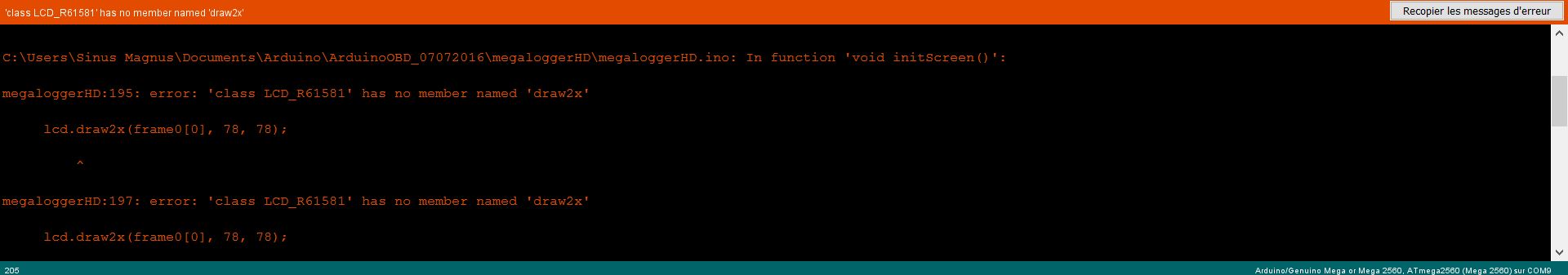

I tried to compile but i ave the following error (see picture).
I updated all the libraries etc....
Did you uploaded the wrong files ?
Cheers
Cheers

Re: MegaLoggerHD is released
Please update MultiLCD library. Latest sketch and libraries package can downloaded here.
